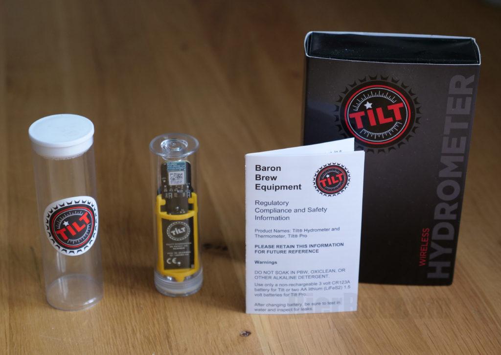

What’s in the box
- A short, yet sufficient, manual / quick start guide.
- The TILT electric hydrometer itself.
- A small transparent tube just a little bigger than the TILT.
- The box itself

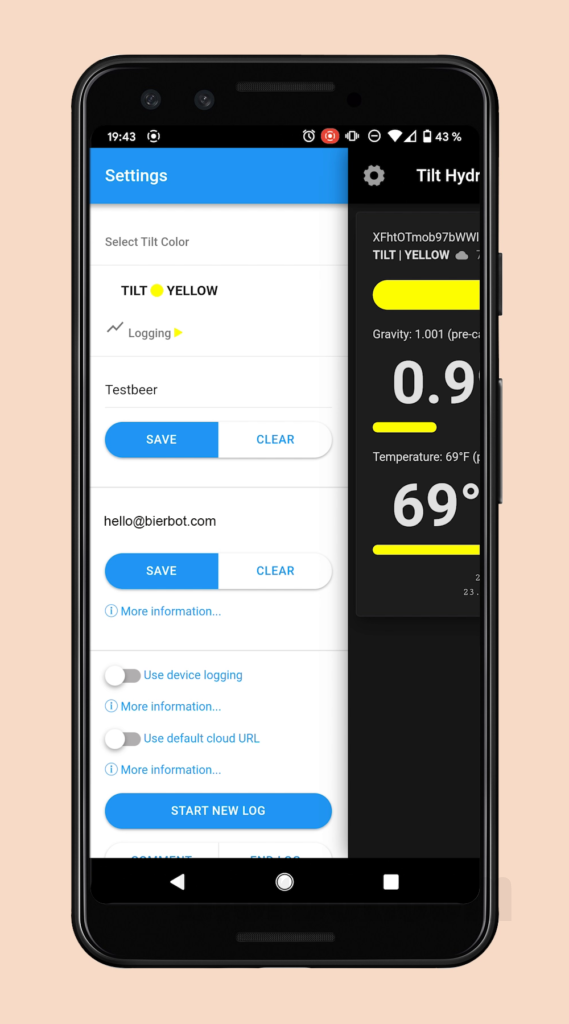

- Enter a beername.
- Enter your @gmail address in the TILTs configuration.
- You’ll received an invitiation from Noah (the genius behind the TILT 😀) to a shared Google Sheets file.

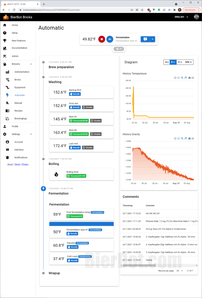

You can also add your TILT to your BierBot Bricks brewery. A detailled tutorial how to do so is available here. In short: Open the TILT 2 app and set your API key as beername and enable cloud logging. That’s it. The TILT will show up online under bricks.bierbot.com:
Attach the SG sensor of your TILT to a fermenter by simply drag and dropping.
Then, create a recipe with fermentation steps. When you start the recipe (load it into automatic mode), your SG is recorded over time. In case of BierBot Bricks that looks like this:
On the left, you will see all temperature steps of your recipe. In this case, the recipe included mashing and fermentation. The currently active target temperature (50°F) is marked blue. On the right, you see your temperature and specific gravity diagrams. You can zoom in and out or use the dropdown on the top-right corner to select a specific range (e.g. “3d” or “20min).
After recipe is finished, a brewing log is automatically created for you. You can either view it online or export it as PDF. Here is a PDF export of one of our last brews:
