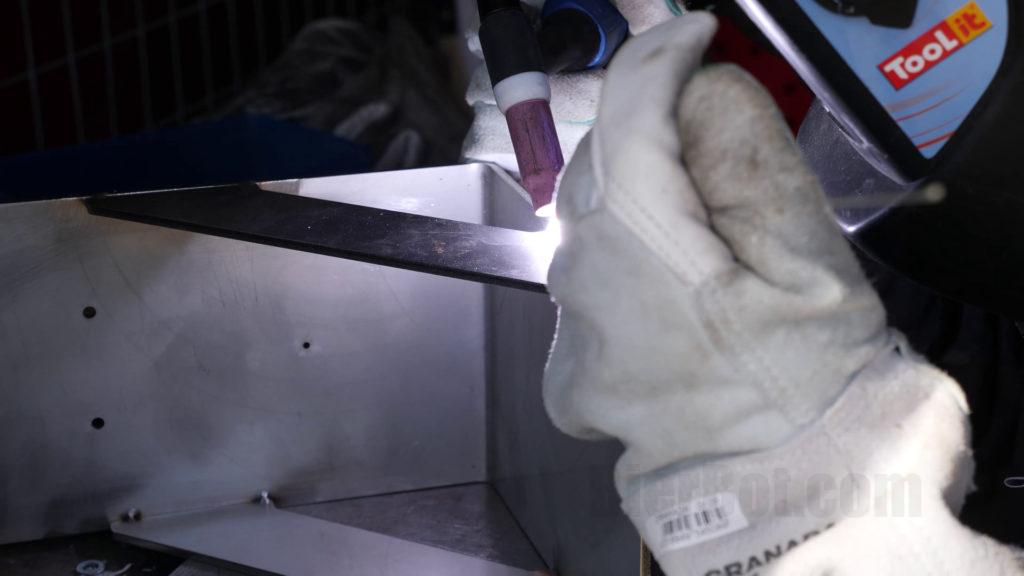

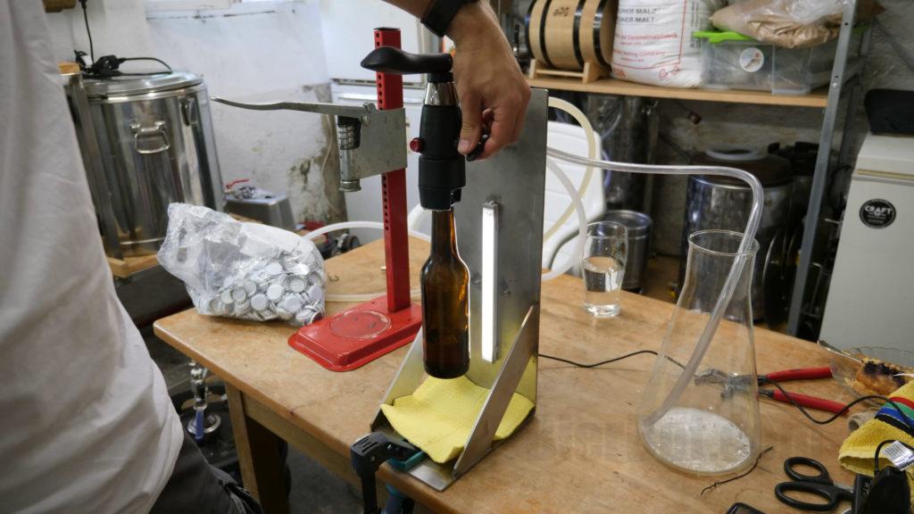

And something something to mount your iTap X onto. Since I love welding, I had to build mine from stainless steel. You can download my CAD files for free here. There are two pieces: The top one with holes for the iTap, and the lower one, for being easily clampable to the table. Both plates are 125mm x 79.25mm and heavily over-engineered with 4mm thickness.
Building a mount for the iTap X
Part of the fun is certainly the creative activity to build your own mount for the iTap X. I wanted to build a stainless steel (no paint job, no rust), LED backlit (so I can always see how full the bottle is), IP68 water resistant (so cleaning can be done by just placing it in sink and shooting water at it) mount.
I got all wholes lasercut by a local workshop and only did the welding and electronics myself. The LEDs are housing in a waterproof aluminium frame and controlled by a bluetooth LED driver which allows me to set the brightness of LEDs using an app.
If that sounds interesting to you, CAD files are available here.

… from the front
… from the back

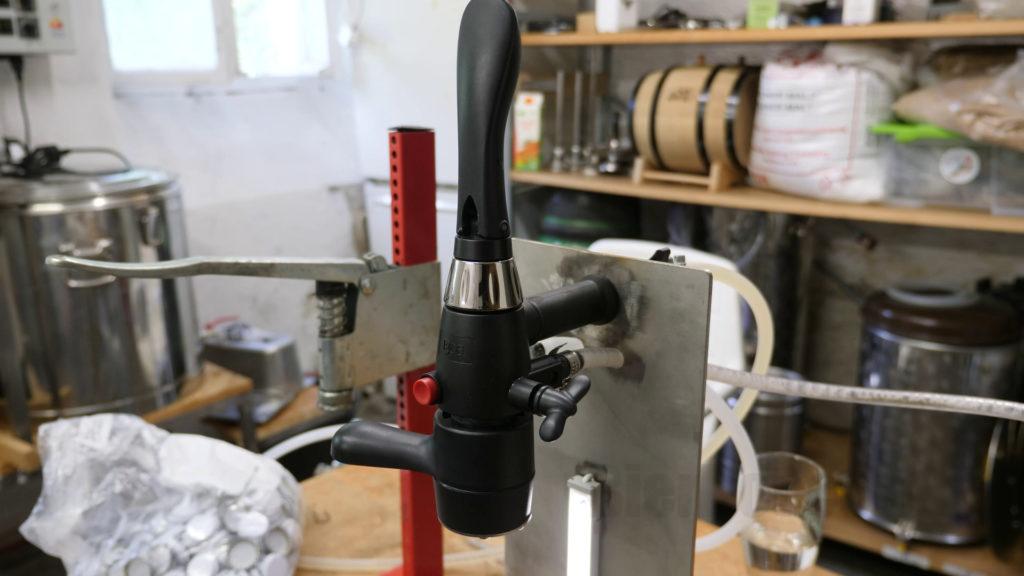

The perfect bottleling process

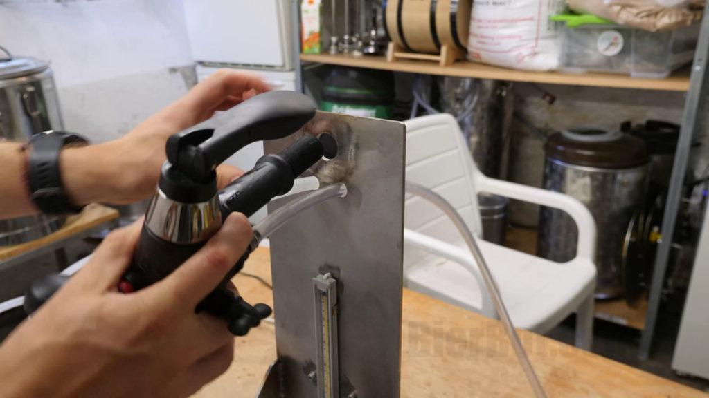

After connecting all hoes, the process is as follows:
- Tighten the bottle into the iTapX using the spoon (turn clockwise).
- Open the valve on the right side.
- Press the red button in the front to fill the bottle with CO2. Don’t be frugal, remaining Oxygen (O2) in the bottle, will decrease your beers lifespan.
- Tilt the handle on top to fill the bottle with beer.
- Turn the throttle knob on the side to adjust the filling speed.
- After the bottle is filled, turn the top handle back to the upward position.
- Important: Fully open the throttle knob (counterclockwise) the equalize the bottle to atmospheric pressure. This step is often overlooked.
- Close the throttle by turning it clockwise to the end.
- Turn the spoon to release the beer bottle.

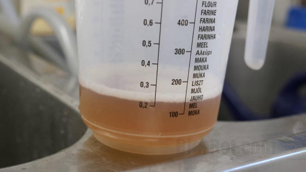

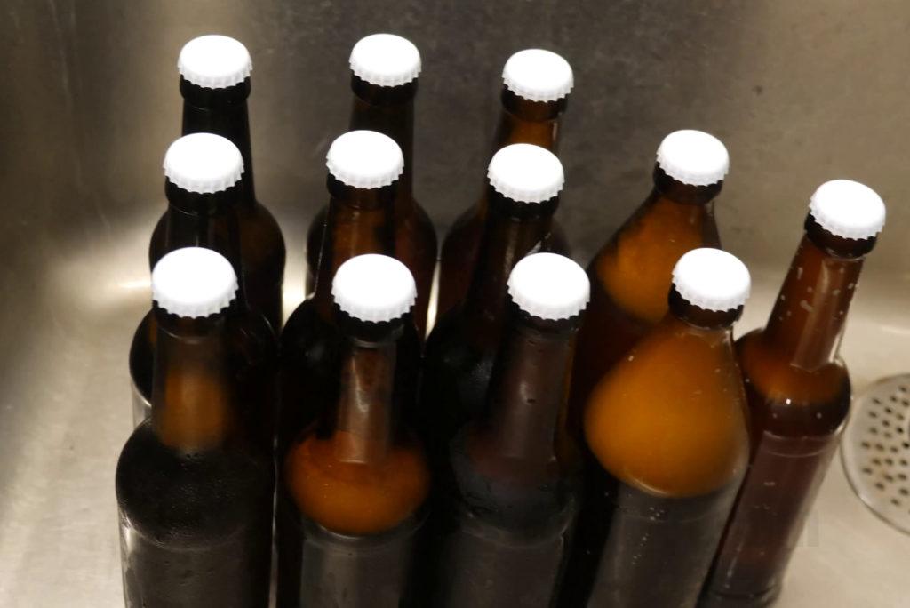

For our experiment we bottled 10*0.3l + 2 * 0.5l = 4l (135.26Oz). The losses with a high pressure beer and low skills on my side totalled to 0.2l (6.76Oz). This equals to losses of 5%.

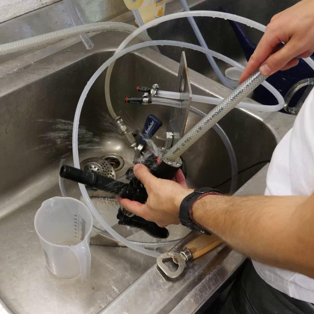

Any brewing equipment review should include cleaning. This is a piece of cake with the iTap X from Boel. The unit is very easy to disassemble (completely). But it’s even easier to to remove some outer parts and give it a little water. I usually just put water through all in- and output connections. Thanks to the IP68 rated mount I can just place everything in the sink!
